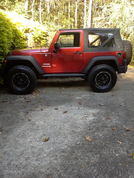

Old Jan 27, 2015 | 10:13 PM
badeye's Avatar
Joined: Nov 2014
Posts: 35
From: Chattanooga, TN
Originally Posted by Tammy
Can u show some pics of ur ride?
I haven't had my jeep very long. This is the only pic I have of it. But these are 35" tires on 17" wheels with 4.5" backspacing. And the matching spare fits on the rear tire carrier without any problems.
You can see it better if you click on the pic.

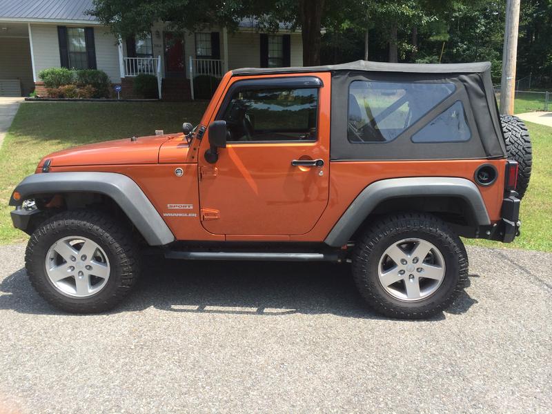

Old Jan 28, 2015 | 04:37 AM
lowendrider's Avatar
Posts: 1,205
Likes: 17
From: Oxford, AL
Spring swap on my '11..with 3/4" spacer added to level... 265 70 17 tires. I gained about 1 1/2" front, 1" rear. Only have around $100 invested. My advice..you can get the springs cheap enough..find a fellow jeeper to help with the install and you'll get a nice boost for a little cash.
