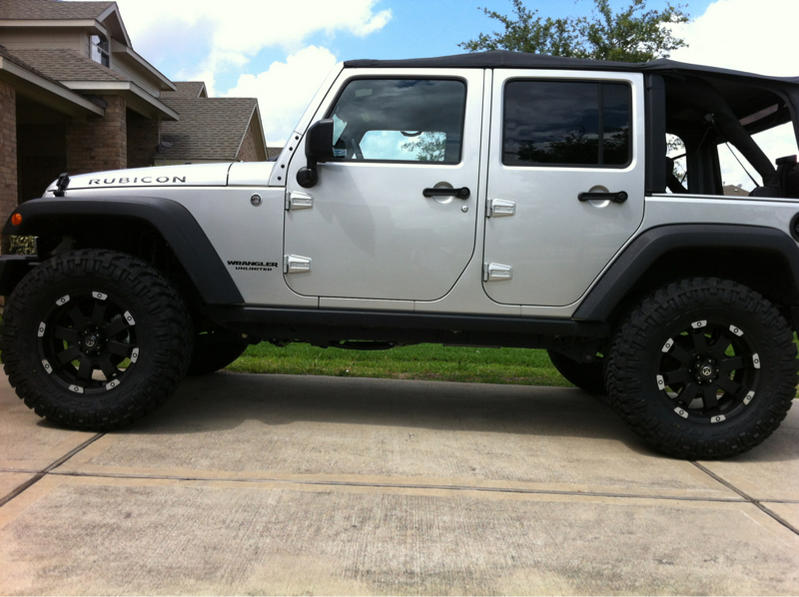

I did 2.5 TF coil lift on 35x12.5x18 Nitto Trail Grapplers. I drive 50 miles a day and it still rides great. The AVE pro cal is a must. I didn't replace my shocks either, just extensions.
