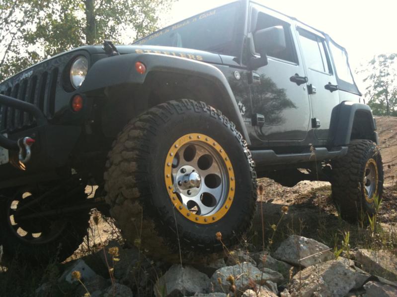

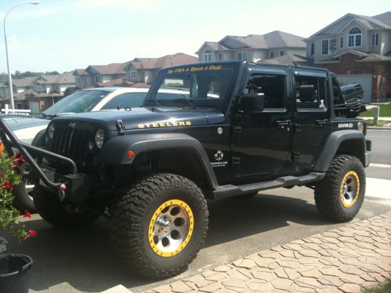

I have a 4 dr auto 35's and 3" lift.... Put the tires and lift on......I'd suggest a Superchip that will help...... Then drive it first for a few months a you'll see it's not as bad as many guys will make it out to be. I eventually regeared to 5.13's a year later. Good luck
