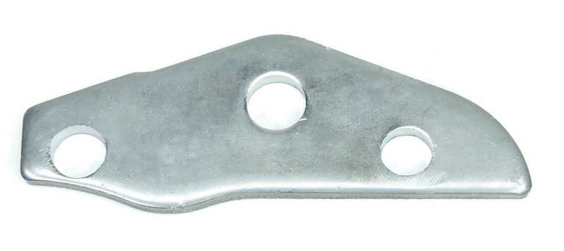

Default i used the gusset plate
but ill say this even the plate gusset could use a tack weld , but it hasnt budged a bit. so they work well , just paint it black. On the passengers side .
10 bucks from quadratec i believe / also get a 9/16 bolt kit and just change them all out . those run about 50 +
one of the small holes in the plate dosent get used , no way to get a tiny nut in there behind it
