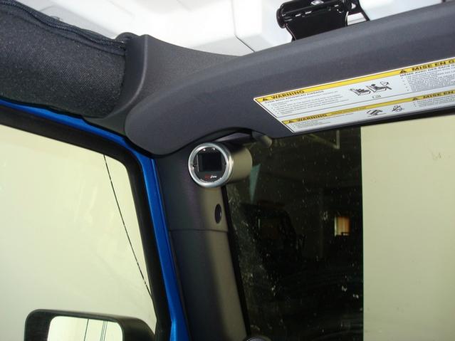

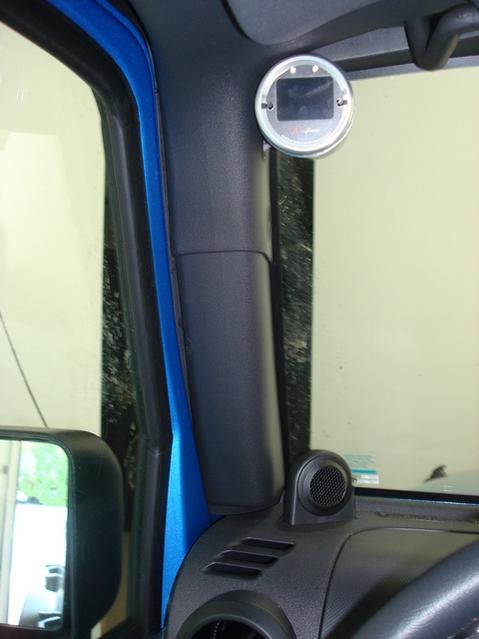

I just installed mine today.

I used this cup but I modified it.
http://www.glowshiftdirect.com/Unive...wivel-Pod.aspx
I cut off the mounting arm...........leaving only a plastic cup.
I cut the cup down 3/4 of an inch (cut off the open end). If you don't cut it down the arm of the sun visor will hit the gauge when you swing it to the side window.
I held the cup into the corner and marked the position of the front edge on the corner trim. The rear of the cup is very close to the windshield.
I removed the corner plastic trim piece in the Jeep.
Held the cup into the corner and drilled 2 holes.
I used 2 machine screws/lock washers/nuts to secure the cup.
Drill a new hole in the side of the cup for the wire harness and reinstalled.
It sounds complicated but the whole process did not take long at all.
My gauge was a little loose in the cup at first so I wrapped it with about 3 winds of electrical tape before installing the rubber gasket and inserting into the cup.
Hope that helps,
Brad

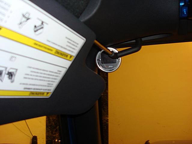

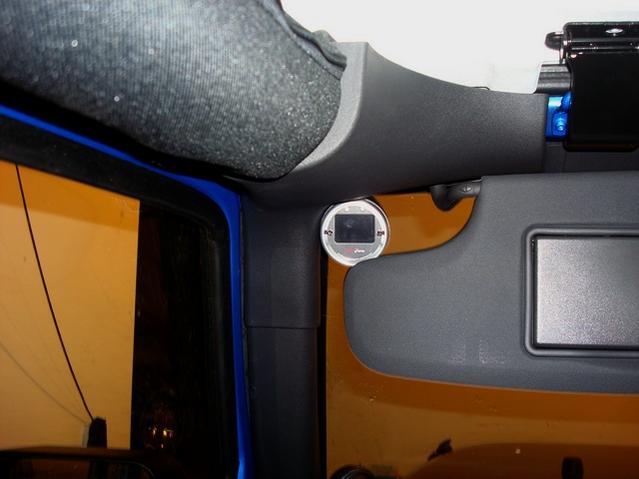

I just added 2 more pics. One with sun visor down and one with it to the side. The only time the gauge is partially blocked is with the visor to the side.
