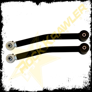

Incidentally, RK's control arms are angled (bent) to give better ground clearance and would also eliminate the stress point in the frame you mentioned since the bulk of the LCA is in fact more parallel with the frame.

Don't get me wrong, I am not disagreeing with you. Just clarifying what I meant.
