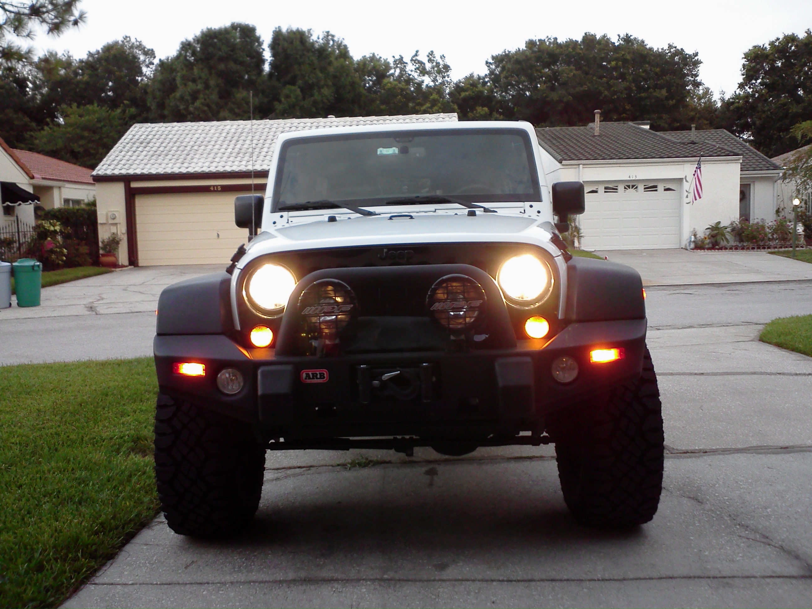

Really depends on how you are going to equip and how you are going to use your JKU. I installed the first July the AEV 2.5" DualSport XT Suspension with AEV Geometry Correction Front Control Arm Drop Brackets and Spidertrax Black 1.5” Spacers with Factory Willys Wheeler 17” Wheels and Goodyear Wrangler DuraTrac 315/70/R17 Tires. I gained 3.5" from my factory Willys/Rubicon Suspension. That is with ARB Deluxe Front Bull Bumper and Smittybilt X2O-10K Waterproof Synthetic Rope Winch which weigh over 180lbs. The rear I have ARB Rear Bumper with Tire Carrier and tire/wheel and weigh over 195lbs. My suspension has not sag and almost level. I use it as a DD and driven over 4000 miles and the AEV Suspension and tires handles and rides great. You see a lot of positive feedback on AEV and the reason I went with AEV because of the heavy bumpers I installed on my JKU.
