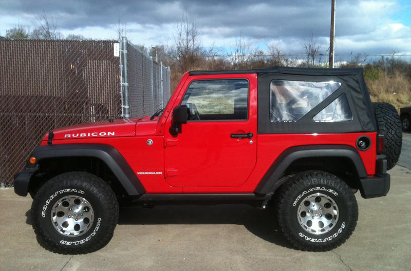

Just added the AEV 2" spacer lift kit with shock extensions on my 2012 Rubi...
I'm runnin' 33x12.5-15 GY Duratracs on MB Razors, 15x8's
