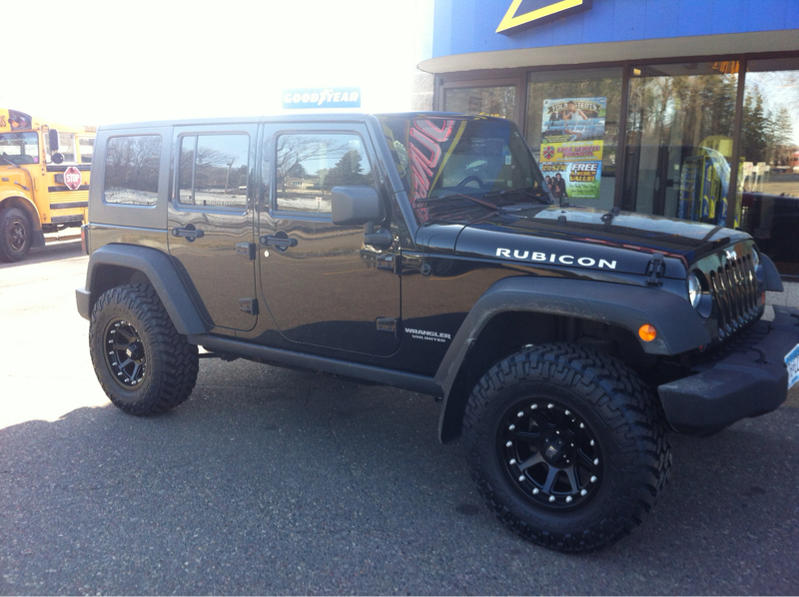

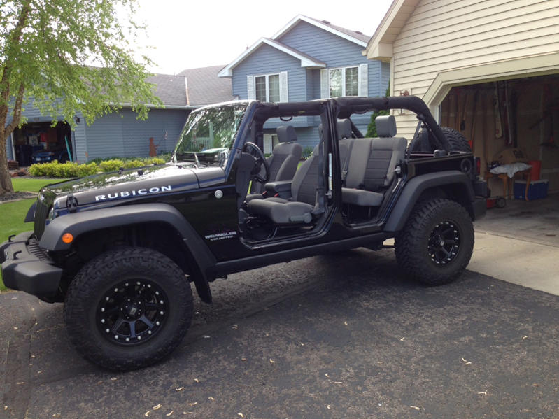

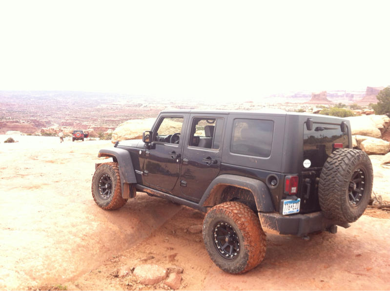

I have the 2in AEV with 33in mud grapplers. I like it the only issue Is medium/ hard off-roading at full articulation you will stuff the tire into the stock fenders do some rubbing on the inner fender. If I would have done it again I would have gotten the tarraflex 2.5 for the extra .5 but the quality of the AEV is also very good
