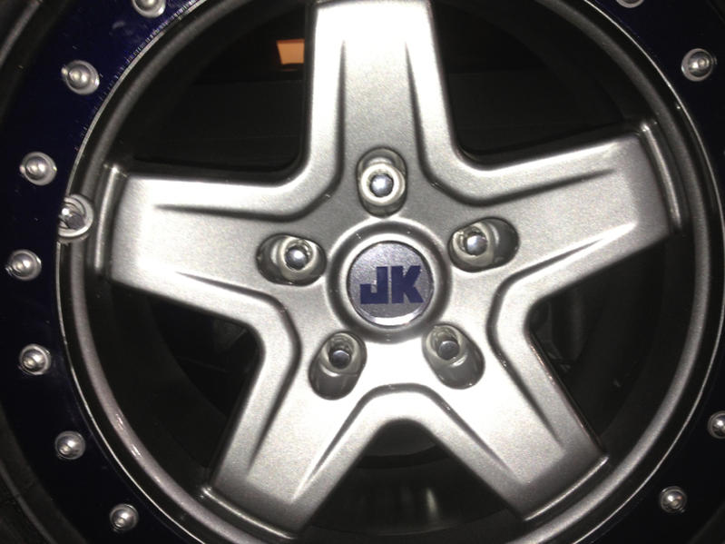

Here you go. No issues other than getting those bitches on there. The rings are perfect. About 2k miles and no leaks or lost bolts.
