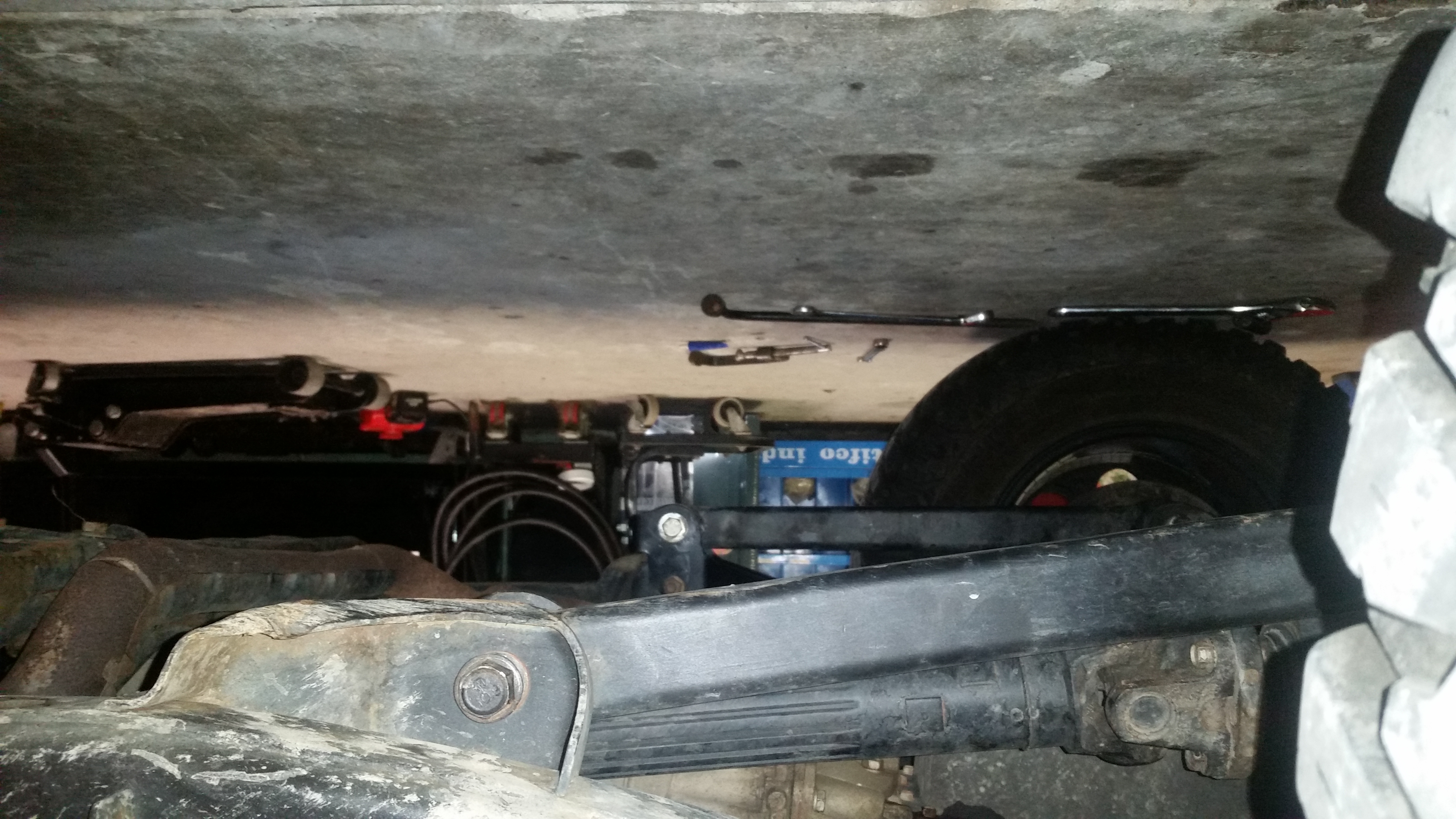

You will benefit from the improved steering and braking with these brackets, I recently installed a set and I've got exactly 5.5" of space there. I cannot say for sure but with under 5.5" of space it may over compensate the angle on the upper link.
You can see a before and after on each side here.
