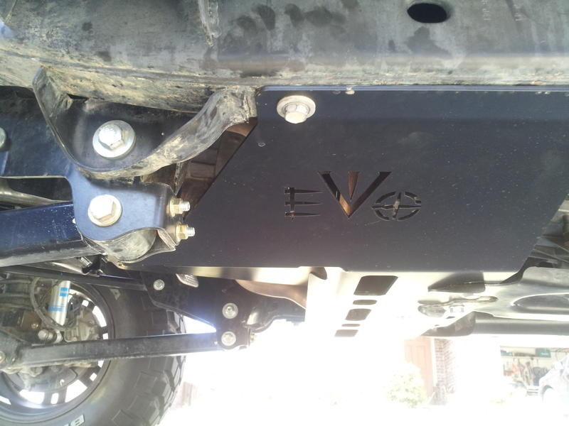

Works fine on mine and I didn't have to make any adjustments. I have the AEV 3.5" SC lift. Heres a picClick image for larger version
