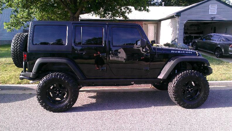

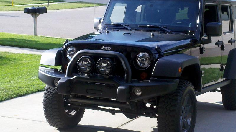

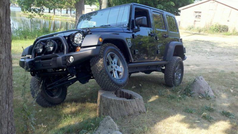

Worth every penny!! Amazing fit and finish!!! Plus I did the 2" AEV BB lift. Now the baby just needs new shoes$$$!!!Click image for larger version

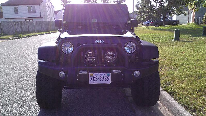

I love mine. I received my 2012 prior to the CODs coming out so I had to drill my own holes. It wasn't bad though. They are pricey though.

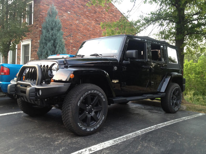

Everything was pre drilled on my 2012 JKU Sahara, just put my front AEV on two weeks ago. The only thing you'll need are some extra large washers to act as shims for the front of the tow hook pieces (AEV knows this, WTF do they not include them?). Also one of the factory holes was not drilled out big enough and I had to enlarge it an 1/8". Now is it worth $1800 (Premium Bumper, Skid Plate, & Winch Plate Cover with Shipping)? It's tough to answer...let's look at some facts: I could have bought "brand x" front AND rear bumpers for that price! It's relativity light weight, only 1/8" steel rather than 3/16, could be looked at as a plus or minus... I spent $1800 and STILL had to buy shims! It'll cost ANOTHER $120 to make it winch ready! Now it was extremely simply to install, no big modifications needed. It does have a clean "factory" look to it which flows nicely with the fenders. The upward swing of the end of the bumper makes my TF Leveling Kit look like a real lift kit! USA made! Overall: the price DID make me gag, multiple times (just did it again), buuut I AM very happy with it. I'm going to eventually buy the rear, but with one kidney sold for the front bumper, I can't sell my second kidney to buy it at the moment. Although my girlfriend still has two of hers...
