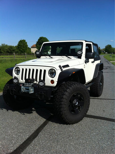

Here is my old 08 wrangler x
Loved the hood so much when I sold my 08 and bought a 2012 unlimited rubicon first thing I did with 150 miles was buy an Aev hood and trek top lol
