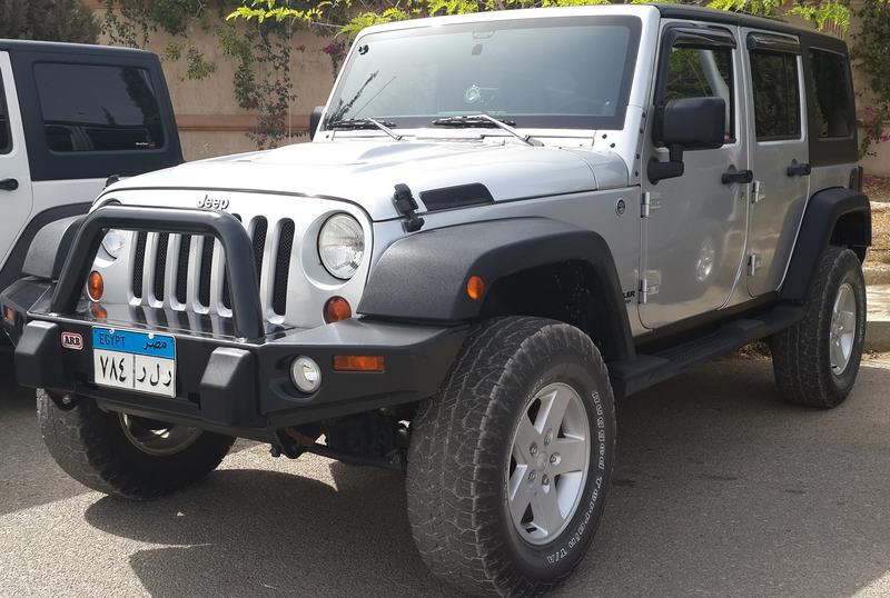

It's easy as pie ....
It took me and a friend less than 1 hour ...
Remove the windshield wipers ... then unbolt the cowl cover to access the hinges bolts.
the sprinkler tubing (easy) ... Remove stock hood ... set aside .... you can figure out the rest
