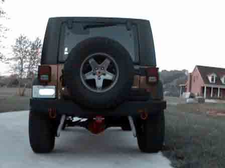

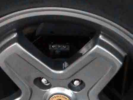

Yup....I have it and love it. I had enough of the bulky light housing taking up so much of my rear view. I have the Mopar rear OR bumper with tire carrier. I cut the wire and soldered a simple trailor type plug to it so I can simply unplug it when I open my tire swing or if I forget it will just unplug itself if forced. I really like it...looks way better not having that gawky brake light sticking up.
BTW...sorry my pics suck...I spend all my extra money on my Jeep not a camera.
