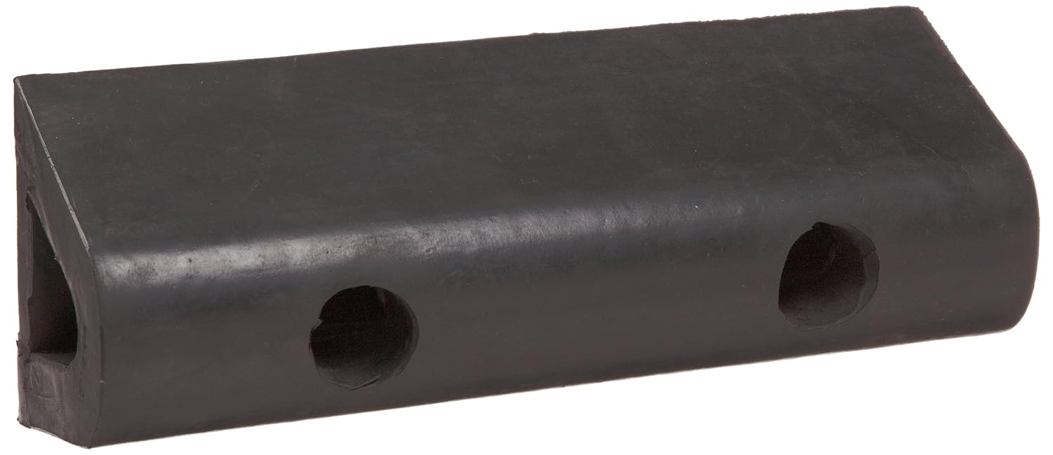

I'm definitely having troubles trying to find some push blocks. Amazon has a few of them listed, but they're not in the size I need and they also come with pre-drilled holes which aren't in good locations based upon I intend to put the Tow hooks behind it.
Here's the closest I found. It is LxWxD= 12"x4"x4". I need something around 6.25"x5"x4" I almost could work with this one by cutting the length, but I need the Width to be at a minimum 4.5" to cover the tow hook.
What I'm highly considering is purchasing the AEV Crush Cap covers because they're obviously the exact dimensions I need and then filling them with some kind of hard rubberized material so they can be used as push blocks. I just don't know what that rubberized material would be.

For now, I'm going to order some replacement crush can covers. Once, I get them and see how they fit around the crush cans I'm going to try and figure something out. I may leave the crush cans attached to the bumper and then put some kind of RTV sealant as suggested inside of the crush can covers to fill in any air gaps between the cover and the crush cans. That way I should get some rigidness from the crush cans for pushing, while the RTV sealant should help prevent the crush can cover from collapsing and getting damaged.
With all the accessories that are available for JKs, I'm kind of surprised there aren't any Push blocks made specifically for Wranglers, seeing as though aside from being an offroad vehicle, Wranglers are also often used for fire and rescue purposes. I guess, there isn't as much of a market for them as I originally anticipated.
