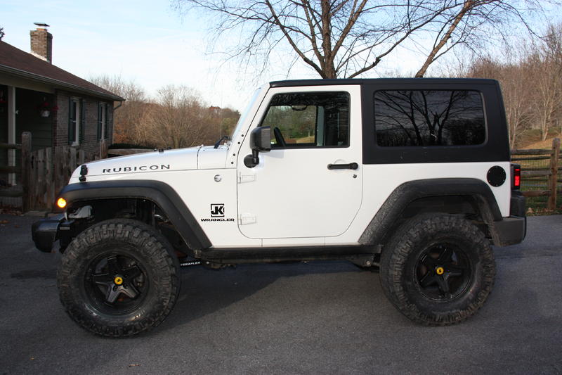

I have the same setup 2.5" TF lift (got 4 door, which gave me a little more) with 17" Black Pintlers and 35" Nitto Trail Grapplers. I haven't even trimmed my pinch seams (yet). Been off road a few times and no rubbing yet.
ID:	253910Click image for larger version
