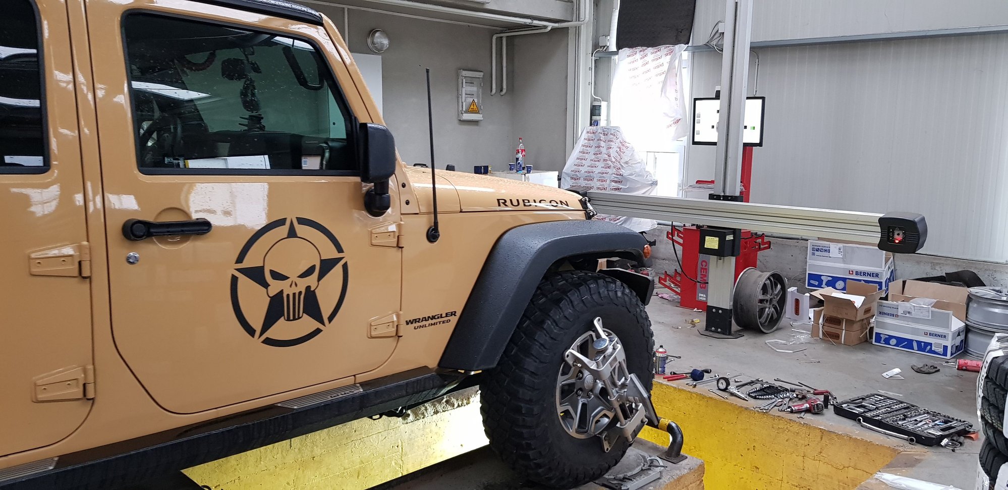

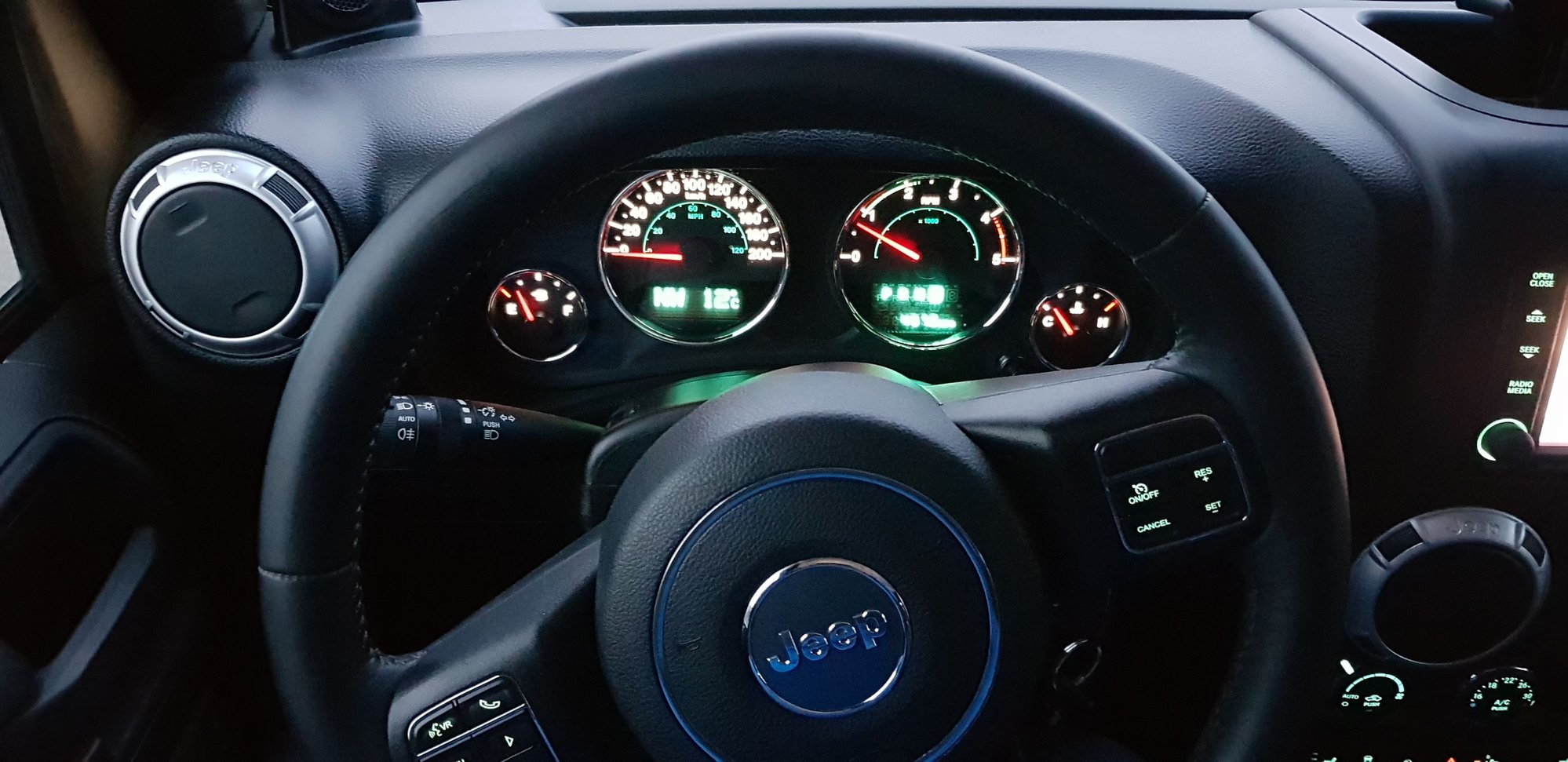

I made for my jeep rubicon a profesional aligniament..all is ok,but same time the light from esp is coming.I ceck with AEV PROCAL if the console center is ok..but is not ok..if I put the right steering wheel ,
the wheels are straight..if I look for the center with AEV PROCAL , then the steering wheel and wheels are slightly left.
Haw to made this to a good aligniament ? First i put procal on my car to find the center, after which we adjust the wheels?

,the problem is as follows. The alignment of the car is well done,the wheels are straight as are the steering wheel..but sometimes the bulb lights up at ESP. I put the AEV PROCAL device on the jeep, to check where the center of the steering sensor is,as indicated by pocal..put all my direction to the left. this is the problem ! to go into service again and to restore the alignment of the wheels according to the indications of the procal device ?

Hallo,on jeep wrangler is possible to reset to 0 steering angle sensor ? I made the direction to the JEEP, I did not check where is the center 0 steering Angle Sensor. After one day I checked with the procal device..center is in 10 grade to the left. And now I don't know what to do..
I have to go to the service again, check before the sensor center and then remake the direction? Or is it possible to reset the center 0 steering Angle Sensor ?
Naw i have problem with esp light..

you need to be on an alignment rack to use the procal. I know people say you can use it but AEV says no you need to be on an alignment rack to use that feature.
see third post. that is the owner of AEV and his brother invented so he knows how it works.

is ok..i must go back to alignment rack ..i use this procal to alignament to make a ather aligniament to this center Angle Sensor at 0
