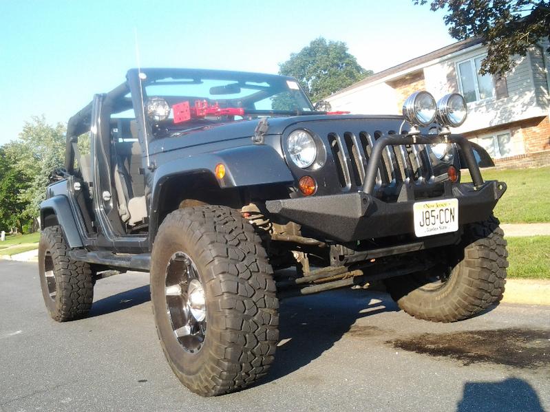

A procal will fixtures speedo, but ur struggling due to the tire size... But u don't NEED to regear.... I had a 2010 JKU Sahara with factory 3.73's and 37X12.50R18 BFG KM2 tires, it struggled a bit but it was okay and I was running those same wheels
Old Feb 6, 2013 | 07:34 PM
Jersey_Devil's Avatar
Posts: 5,255
Likes: 11
From: Bellmawr, NJ
Here's a pic
