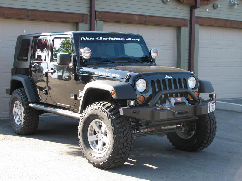

I went with the AEV 4.5 lift for a couple reasons. I'm gonna lay it down, I'm a college student and the daily driving out-weighed the extreme wheeling. Hopefully that doesn't sound confusing. Jumping up to 37's is going to cost quite a bit. For me just the lift and tires ran me roughly $3100 then I had to get wheel spacers to clear the 37's and then factor in another $700 for the install price and it gets expensive pretty dam quick but the result and ride is SO dam worth it. This is what you'll end up with Good luck on your choices.

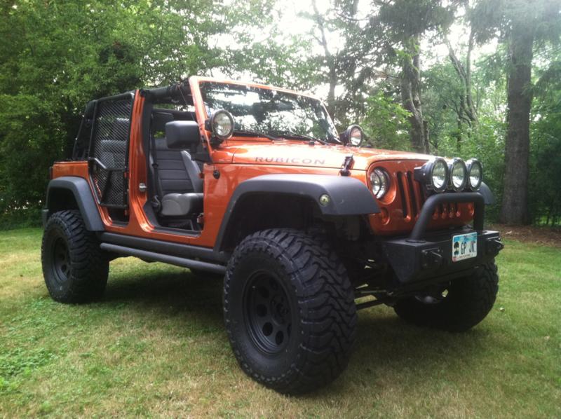

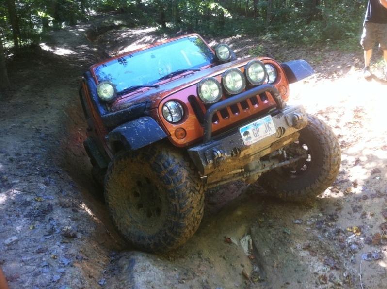

AEV 4.5" as well. Great on road, better than stock ride and very capable Offroad.
