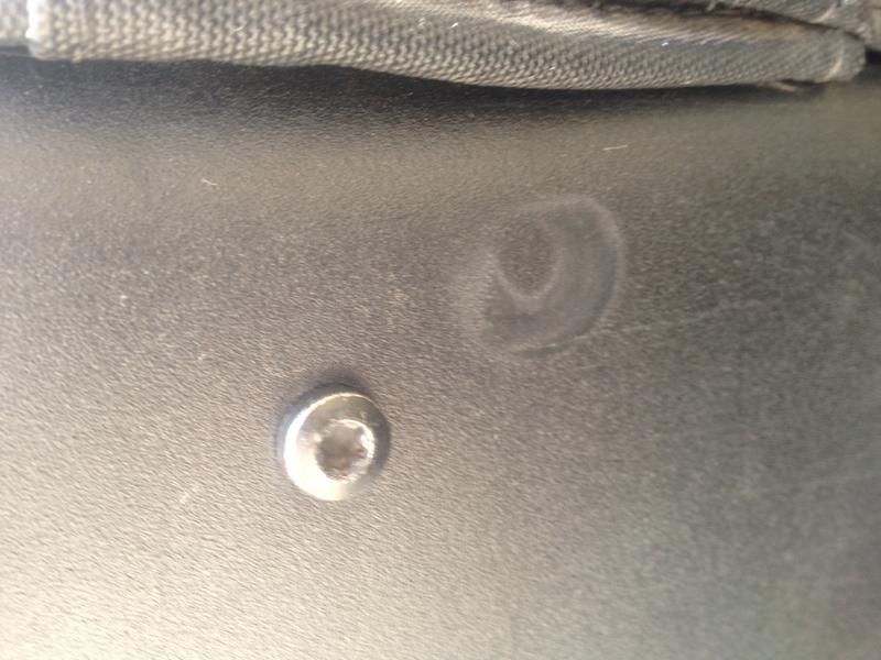

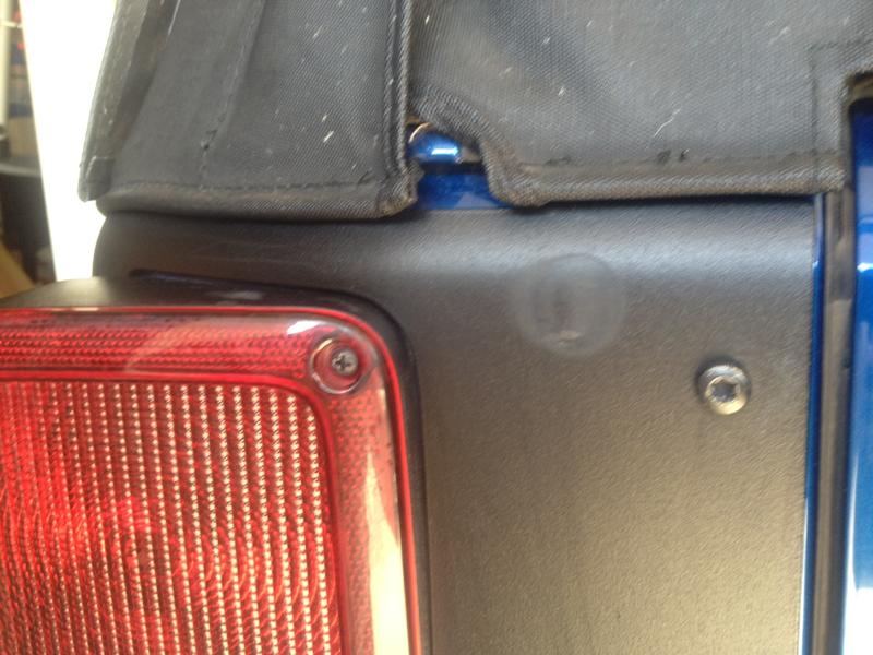

I should add that I use mine with my Gobi roof rack. They are way stronger than the body of the jeep and the metal pads Gobi supplied. Before the corners were put on I had a tightening issue with the rack when I was offroad and dented the body a bit (not really bad, but it bothered me). Once the AEV corners were on I had no issued no matter how loose or tight I made the Gobi rack.
I don't run the Gobi rack all year round so when it is off the points where the rack adjustments contact the AEV corners were rubbed smooth of their textured finish, but they are still black from the powder coating. Therefore I am happy and very impressed with AEV's powder coating.
Here are some pictures of what I am talking about:

Thanks for all the input! very much appreciated! I just placed the order and now I just have to get the courage to do the drilling. Did anybody else have problems drilling the passenger side between the hinges? I just got a Gobi rack also and was really surprised to see those rub marks kinda worried now but hopefully the the new corners will protect it a bit better.

AEV corners really help the gobi, so dont worry.
Check out this one (dents pre corner install)
