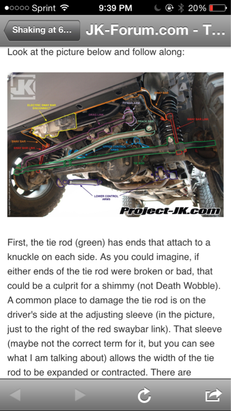

I had this issue after my lift. Even after taking it in to my installing mechanic. It started with the steering taking a quartet turn in one direction and the occasional ESP light. My trackbar was not torqued enough. It would move a bit back and forth. Basically it took a quarter turn to catch. Start there. Make sure it's torqued to spec and not any less. Good luck.
