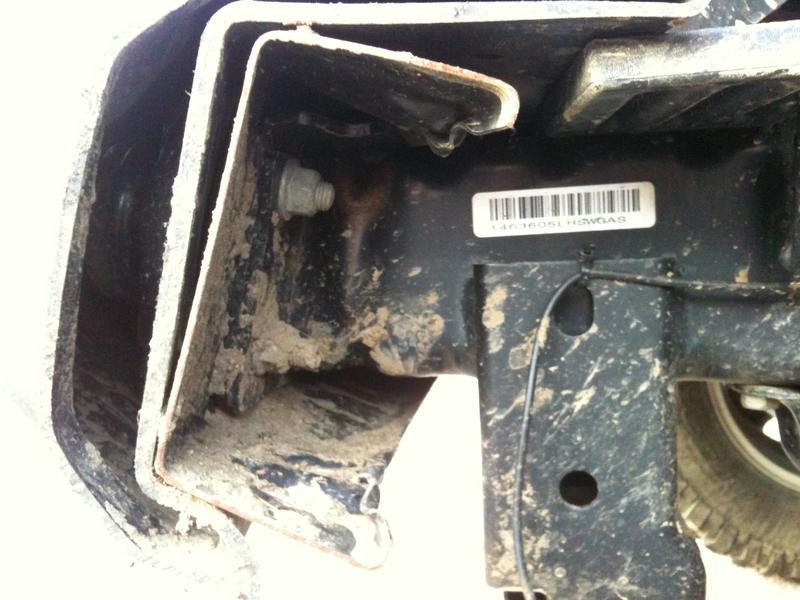

Here's a picture
Old Mar 15, 2011 | 03:24 PM
animated_robot's Avatar
Posts: 385
From: Baton Rouge, LA
Originally Posted by uselessllama
Here's a picture

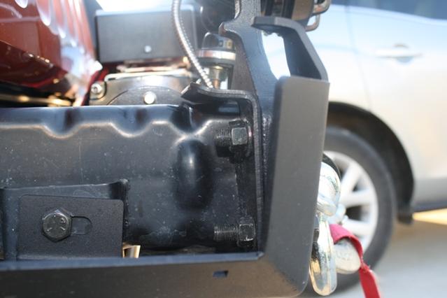

You will have to straighten it out the best you can. the Woods bumper will fit and as you tighen down the bolts the bumper will mold to it. I know it doesn't make since, but when I purchased mine (bumper) it wasn't a tight fit until all the bolts were tighten down.
are you going to use you tow hooks with the bumper? If you use some tow hooks you might be able to fill the gap in, but i would get a torch and try to straighten it out best you can first.
Here are a few shots of mine.
