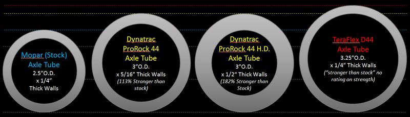

Aftermarket Dana 44 Front Axle Tube Comparison - Stock, Dynatrac and TeraFlex

Old Nov 18, 2011 | 12:19 PM
CH10's Avatar
Joined: Jun 2010
Posts: 181
From: El Paso, TX
Nice visual I wonder how the TeraFlex compares.
Old Nov 18, 2011 | 02:23 PM
f2fast4u's Avatar
Posts: 495
From: Dallas, TX
Almost looks like the Teraflex could sleeve the outside of the stocker.
Old Nov 18, 2011 | 02:30 PM
TeraFlex's Avatar
Sponsoring Manufacturer
Joined: Apr 2007
Posts: 6,824
From: Utah
Originally Posted by 97jeeperdrummer
Makes me wonder why Teraflex priced their axle the same as Dynatrac, and the Dynatrac looks clearly superior in every way..
Strength is not just in thickness but diameter also.
I will agree with this statement look at the new prorock 80 the tubes arent as thick as the 60 or even the PR 44 for that matter the 4 inch diameter axle tube makes up for the thickness
Old Nov 18, 2011 | 05:04 PM
JKred's Avatar
Posts: 1,467
From: Torrington CT
Correct, thickness well help against denting but bending strength come from diameter and cross sectional area, diameter being the largest component. That is what a hollow tube is almost as strong in bending/torsion as a solid rod.
My feeling by looking at the pic is that. Pr44 and pr44 hd are stronger against denting than the tera, but are most likely close to the same in bending, while the pr's are most likely heavier due to added wall thickness.
