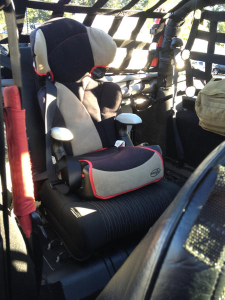

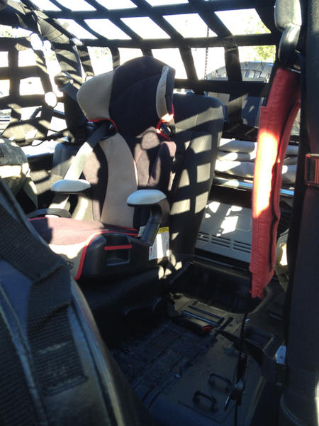

With the kids and regards to the seats/harnesses: when they fall asleep now I worry about the belt not being adequate to hold them in. Also having reclining seats in the rear would help with that head slouch they get when they crash. The road noise from the tires, wind and stereo knock them out I want them to stay secure but want to be legal.
I went with the Baja RS seats which fully recline and slide forward and back like the stock seats would. I have one child myself and what I did was remove the stock bench seat and moved my front drivers seat to the back. It's a much more comfortable ride for my daughter since the seat does recline, plus she sits a little higher so she can see more.
