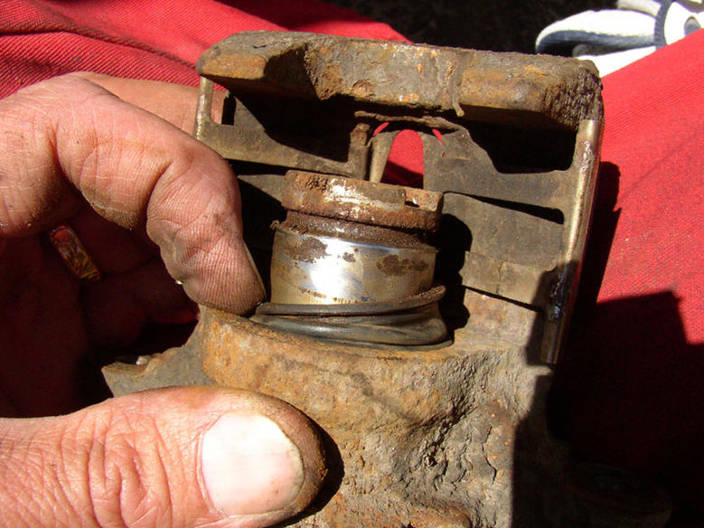

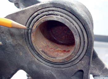

When you originally replaced the pads, were they evenly worn? Or was one pad more worn than the other?
That could be a caliper piston sticking.
(These aren't jeep, just photos stolen from the internet)
