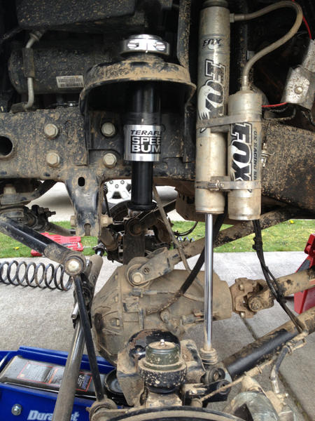

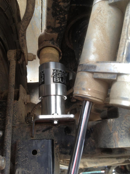

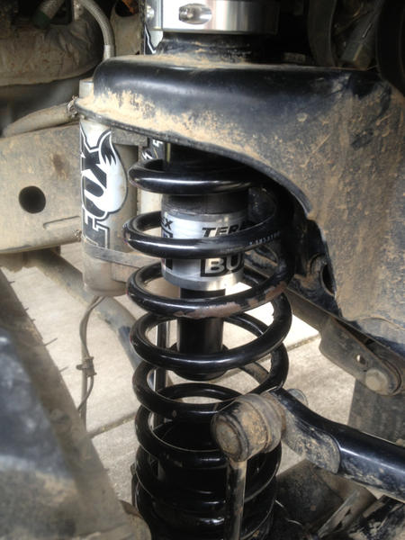

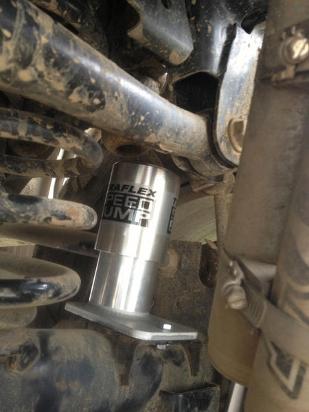

I'm running Fox shocks and the Teraflex speed bumps on a 3" lift. The speed bumps are a huge improvement for ride quality, you maintain a smoother and better control through rough sections of trail. My wife loves the fact that I no longer bottom out on the rubber bump stops.

Here's a few pics
