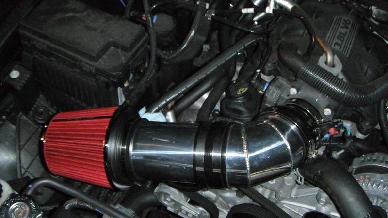

I did a DIY using 4" Specter tubing, removed the rubber flap next to the radiator to allow more air in from the front. Noticed about 2mpg Avg over a few tanks of fuel after the install. I actually added on another 6" section that I cut down to about 4" to extend further into the original air box location. I used a L bracket from Home depot to secure the filter and keep everything secure.
Name:	DIY JK air intake 4inch spectre tube 3.jpg
I thought about buying a kit, the only thing is the cost and it restricts air getting to the filter. If you look at the stock setup, there is a small slot for the air to come in. Costs for everything was about $100
