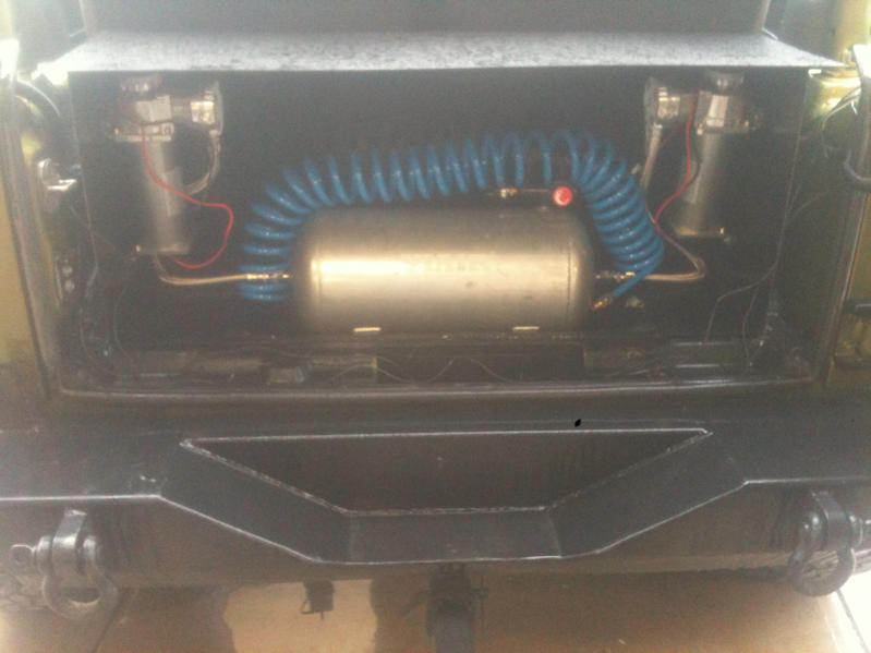

Had a few conversations with some of the local shops and have located some bead locked 3 stage bags. With witnessing the capabilities of one of the shops golf carts, I commenced my build.
First stage air.
For the air system I chose to go with the dual 480c viair with a 5 gallon tank. 3.53 cfm and a 50% duty cycle at 200psi. Which should allow me enough air that I won't have to have it running all the time. (as these will be mounted in the back of the jeep.)
I'll have to do a little more research as I'm not sure how large my perches will have to be to sit at a good ride height. Also to triangulate I may need to remove my gas tank and do a fuel cell. Should be fun, I've see plenty of offroad vehicles running airbags now. I am really liking the forced articulation, the ride height adjustment on the fly with multiple angle adjustment. Think of the possibilities.
To be continued.
