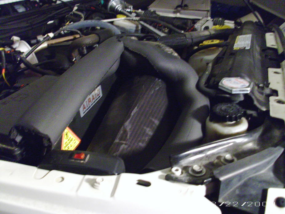

MKJeep has modified his Airbox with foam and sealed it more to help reduce a possible hydrolock. I am sure he will chime in and have photos!
Also, invest in a pre-filter it is basically a water repellent bag that fits over the airraid filter and pro-longs the cleaning intervals and helps filter out finer dust particles.

........Click image for larger version
no probs with mine.

Originally Posted by mkjeep
........Attachment 39318
no probs with mine.
That is nice. I will first clean it and do the same.
Where do i get the plastic cover from? this modification will not effect the performance of the jeep?
By the way...the engine is clean...I have mud and dirt all over
I used roof flashing and cut to fit. It's clean because every so often , I simple green it, then wd-40 everything.
The pre-filter is roof flashing? Im lost
Thats a great idea with the foam and pre-filter, should help out.
Nooo, the roof flashing is the front of the airaid box since it didnt have one. Ordered the pre-filter from O'Reilly's auto parts.
