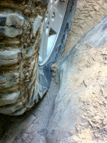

I haven't yet. (Knock on wood) if your tire is a load range C then you can usually get away with a lower psi. The stiffer sidewalls of D and E range tires could burp air more easily so sometimes you can't run as low a psi. I had a lot of problems with a load range E tire last year. Lost the bead 3 or 4 times.
Here is a picture of my mtr/k's at 10 psi going over a tree root. Lots of sidewall flex.
