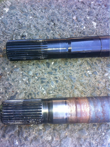

I have a 2012 rubicon, don't know if that makes a difference but I went back a forth with alloy USA. The right side kept leaking this is what I found

The top is the alloy usa the bottom is factory. Where the seal sits its machined smaller than the factory. They sent me 3 different sets all the same. So on the third one they refunded my money and didn't want the third set back. Now I have them sitting in my garage for over a year. Go Ten factory or RCV's

Why don't you get a welder to weld around te shafts then have them machined down to the right diameter? Wouldn't take much.
