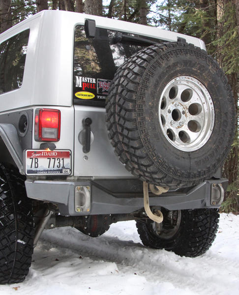

I've been running the Aberle Off-Road Cast Aluminum bumpers with no issues.
Name:	rear small.jpg
Load path for extraction points are directly to frame.
I love the way the swing out tire carrier follows the factory tailgate.
Very Stout swing-out.
