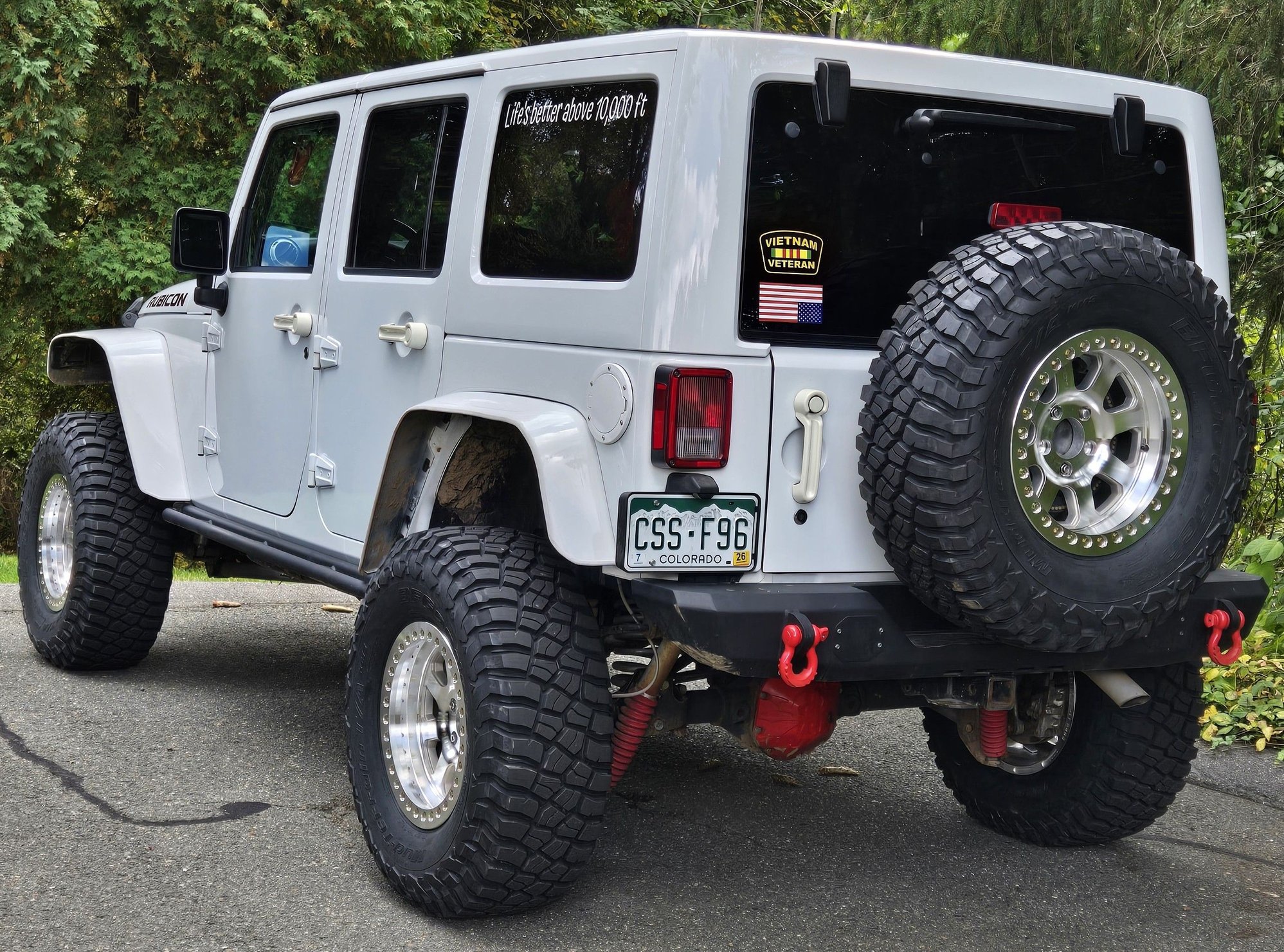

I agree with AZJeeper. Up against a tree or rock wall, something's going to bend, either the flare or the fender.
If you are looking for full coverage but more room underneath, there are lots of YouTube videos on modifying your OEM flares. They basically cut back the inner fender liners & support structures.
The price is right ($0.00), the flares bend even more easily (less breakage), you can cut them back as much as you want, and there are cheap replacements in every junkyard.
