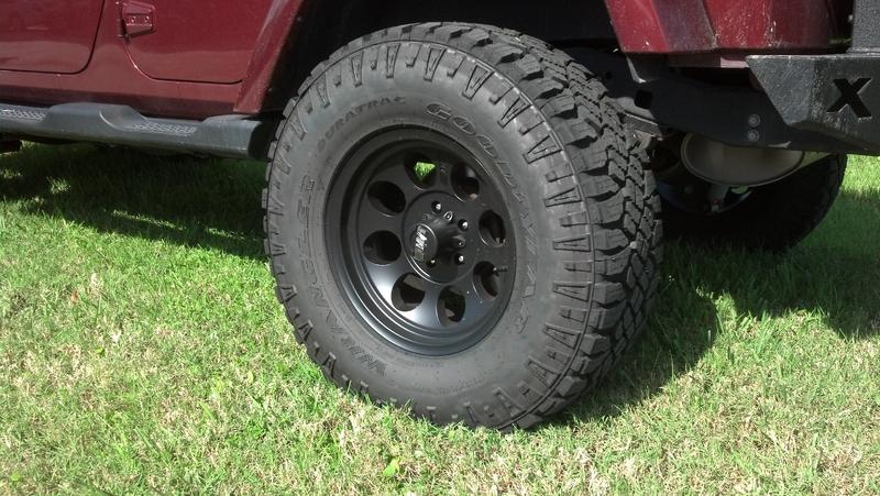

Old Apr 21, 2014 | 01:59 PM
Sahara Lee's Avatar
Posts: 719
From: Lakeland, Florida
Originally Posted by nthinuf
I think I would find a different rim with the appropriate backspace, doesn't really make sense to buy brand new rims that you have to also buy spacers just to run...
Ditto dat!
