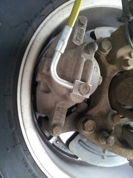

I have American racing ar 23 15x8 3.75" BS and they fit fine. I'll snap a picture of the caliper when I get done with work.

There you go. Hope that helps.

Wow thats tight!

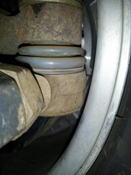

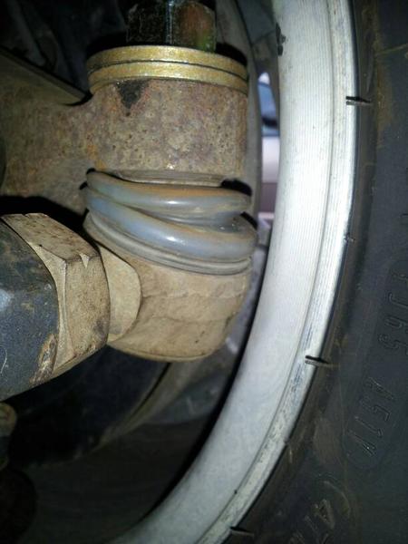

You should see my synergy tie rod lol. The caliper has about 3/8" clearance and is in no danger of hitting the rim.

It only hits if you rotate it all the way forward, but that hasn't happened. The washers are there to seat the taper so I could tighten the lock nut.
