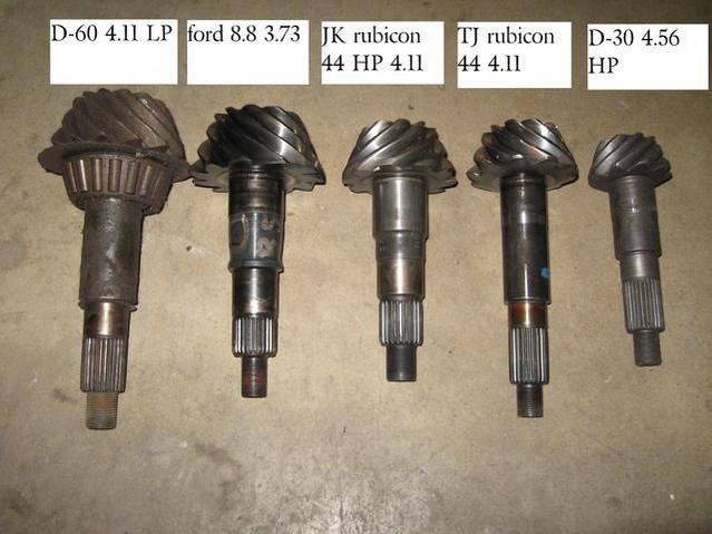

Originally Posted by thegoat
The Rubicon D44 axle is basically the same as the D30, the tubes are the same thickness and diameter, however the ring and pinion are a different size. So spending on a Rubicon D44 is the same as spending on your D30. I would save and purchase an aftermarket axle.
The problem with the 30 is this...
<img src="https://www.jk-forum.com/forums/attachment.php?attachmentid=388436"/>
I've see this before. I'm curious what a stock 3.73 looks like in comparison. I plan on running my stock 3.73 Dana 30 until it breaks with 37" mud grapplers.
Sleeve, gusset, and truss and it won't break.
That won't help the ring and pinion gears on the 30. The Rubi axles are fine, beat the hell out of mine and never had issues. I sleeved, gusseted, and replaced the ball joints with some aftermarket units. Do that and you will have a fairly bulletproof axle for under a thousand bucks, after you get it that is.
I know when you go up in gearing the pinion gets pretty small but how is it in it stock 3:73. I don't plan to regear since I have a 2012 auto.
