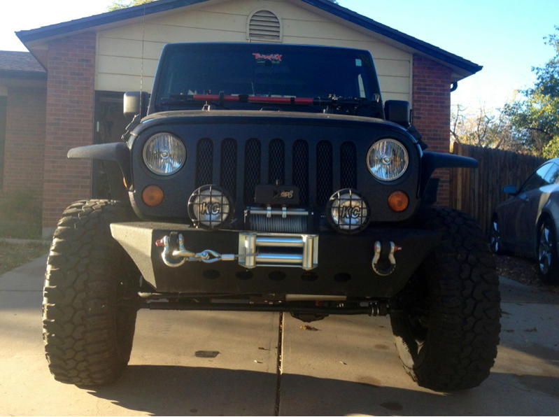

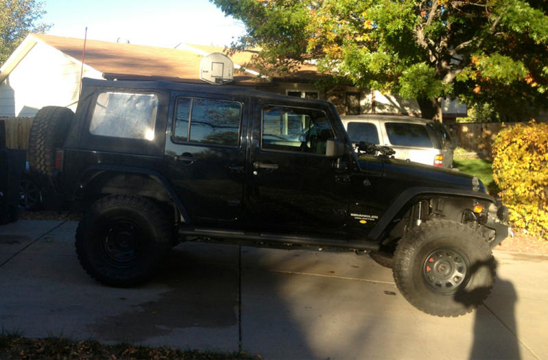

Finally done except for the door edge trim but the edges did clean up nicely so im gonna go without for a while and see how it goes . Sorry for the crappy pics .
