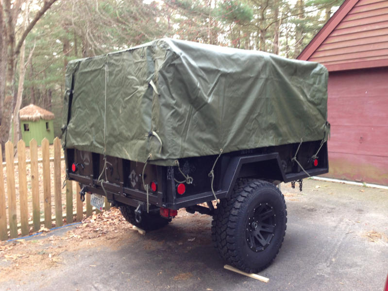

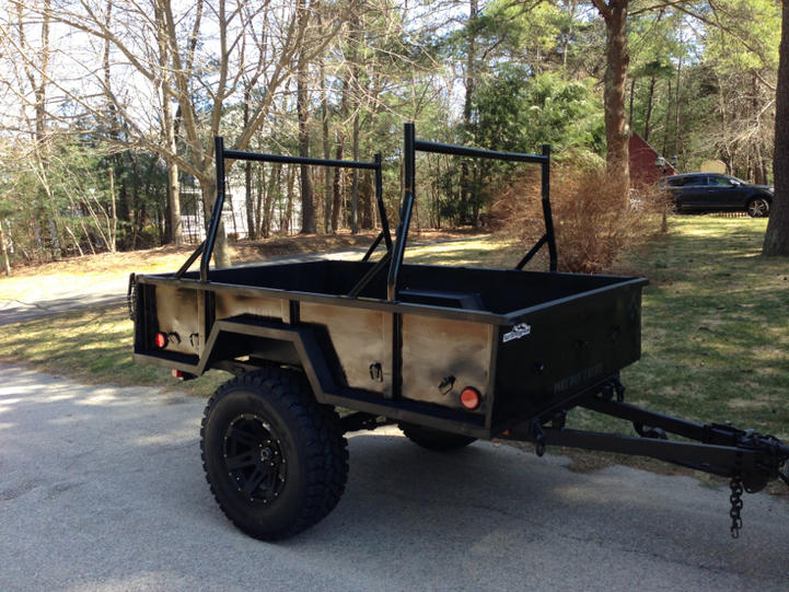

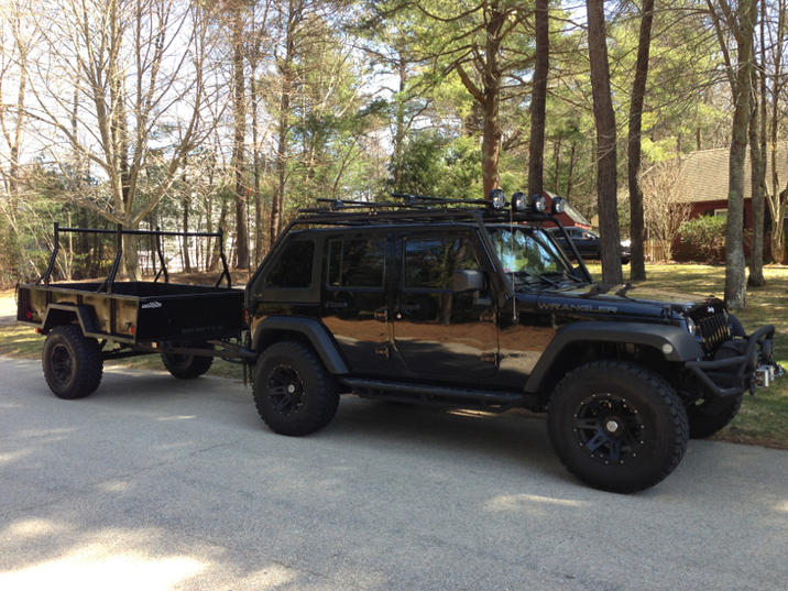

I just finished my M101. Looks great, tows great, and tons of room. Swapped out the axle and put on matching wheels.

Swapped the axle to reduce weight and have hubs to fit same bolt pattern on jeep so spare would work on jeep and trailer if needed. Bought 3" axle so I could use original springs and mounting hardware. You can easily knock off lower shock mounts and use on new axle. Kept old spring but added new Monroe shocks. Bought axle from place in NH. Think it's called Neuro. Paid about 250 inc hubs and shipping. The original axle wheels and brake system probably weighs few hundred pounds more then new axle set up.

M101a has hand brakes which in my opinion are not needed. The other versions of M101 trailers have surge brakes. It was a fun build and still many ideas to do.
