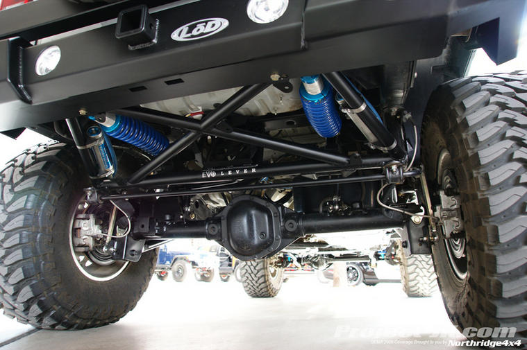

From what I have gathered from my month long research of bumpers, the LOD would excel in a towing situation. Their bumper not only bolts to the frame rails they also have you drill a couple of holes into the center cross member so the center of the bumper is anchored as well.

Hm... Didnt know you have to drill into the cross member. So it doesnt use the holes that the mopar receiver goes into... good to know. Do most bumpers need to be drilled somewhat for the back? or just a few.
The holes used by the factory receiver go through the cross member horizontally. The new holes required for the LOD go up vertically through the cross member.
Hey I just noticed in this image,,,,umm what holds the slider in the hitch?
I don't really like the idea of drilling, but for the bumper I would not necessarily so that is a bad thing, just some extra work.
The Expedition One does not require any drilling. I say one point scored for the EOne.
My problem is the score is tied and I need a tie breaker, lol or the wife is threatening make the choice for me before the tail gate falls off

The picture you are looking at is of our old bumper we do not make anymore. The Signature series bumper (That is shown below) bolts to the frame rails and the rear crossmember. The Crossmember has 2 bolts that go through it vertically and also 2 bolts that go through the crossmember horizontally that you can't see. The only one in the crossmember that needs drilled is the drivers side vertical hole. Let me know if you have any other questions.
