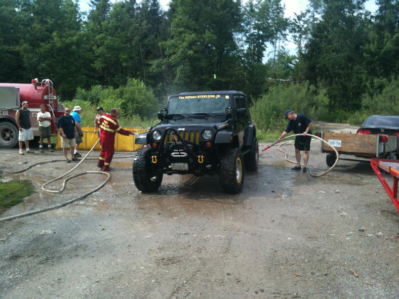

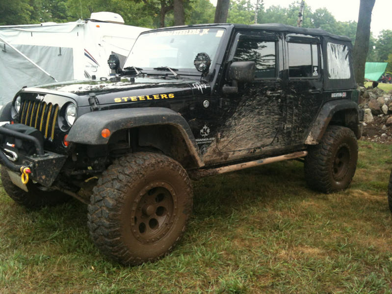

Hi Jeepwave ..... We met Sunday on the trails in Bobcaygeon why did you leave early?
Anyways I don't recall from you or reading this thread if yours is manual or auto?????
Now we have a very similar set up and I agree with the post 5.38's are overkill and IMO that is true!!!! If yours is a manual go 4.88 if it's an auto like my 09 X after doing tons of research last year I'd go 5.13's that's what I did and I'm happy with it.... When you read they're prone to breaking(smaller components) that's true as the guy stated IF you're doing heavy wheel'n. So get your gears and that stinger we talked about lol it'll look good on your jeep. Oh yes also remember after you regear...... if you play in a lot of mud and you get stuck if you can't get out after a few honest tries get winched out!!!!! Spinning in mud hard is when you'll blow up the new gears!!!!!!
Good luck.... Rob
