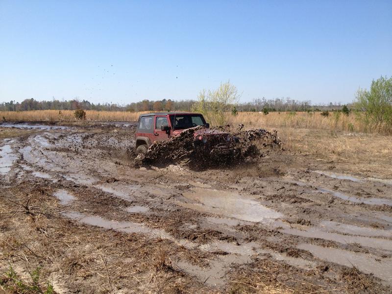

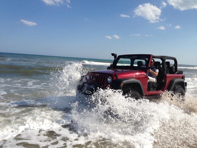

I have the Rough Country Series II 3.5" lift. I netted 4" of lift from it and I have not had any problems with it. Its not even sagging handles great. I'v flexed it out aired my tires down wheeled it decent. I also go to the beach weekly during the summer.
Great lift my DS angle is great no need to change that Steering is great no problems with that. all for $600 with an exhaust spacer and shipping costs.
TBH people can talk trash about rough country all they want. But if they put out sub standard parts they would have lawsuits up the ass and would be out of business. I have never had any problems with their products and will continue to buy their products.

Whose that snorkel made by??
Old Jul 6, 2013 | 04:11 PM
Krawlersaur's Avatar
Joined: Oct 2012
Posts: 347
From: Fort Campbell, KY
Looks like Rugged Ridge. I have that one, and love it.

What he said I love mine too
