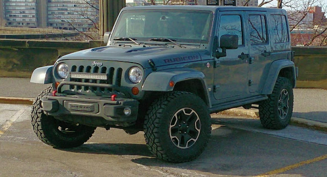

Given that you have the 3.8 and not the 3.6, and taking for granted that you have the 4.10s, I would go with the 255 also.
If you want the looks and maintain as much function as possible with that engine,, I believe that the 285/70 would give you that bigger and wider look you might be after. I know it is not in your narrowed down choice, but I believe it is worth mentioning.
I would highly recommend GY Duratracs in that size.

X2 on the Duratracs. I have a 2" BB and run 285/70R/17s with Bilstein 5100s

I live in Colorado and the winters here can be pretty brutal. I have been running 285/70/17 Duratracs with a 2.5" lift for a while and I have only good things to say about them. The traction in snow has been great, ice not so much. But I have taken them in all conditions and so far no issues or complaints.
