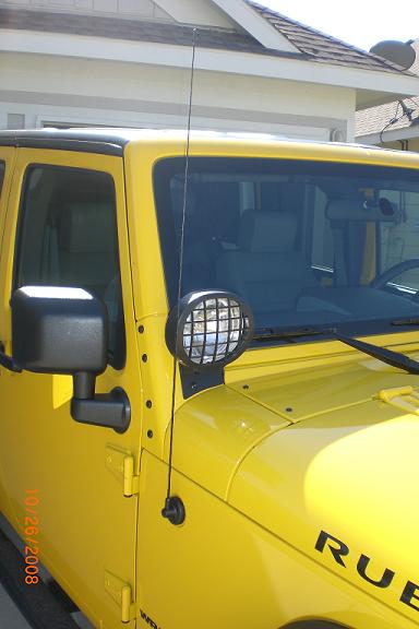

I had been looking to replace my antenna with a black one with no luck. All I could find were the Shorty style, and I dont like them. So I took the stock one off, taped the threads, and sprayed it with "Plasti-Dip". I gave 3 coats just so that each coat would not produce any drips. As I'm going with flat black wheels, the stock color didn't look right.
I think it looks great, and it has a rubberized protection that keeps it from damaging my windshield lights when it hits it.
Total cost $3.99

Originally Posted by Choppus
Thanks for the right up. Let us know if it effects the FM radio any.
There have been no ill effects from the Plasti-Dip. It is basically a rubber compound that comes out wet and dries. Unlike paint that can actually have some metal flakes in it for color, the Plasti-dip has nothing that would interfer with reception. Should be able to put 20 coats on with no change in reception quality.
yes........it doesn't matter how much rubber you put on it, it won't affect rf from getting to the antenna at all. BUT......I'm wondering, have any of you compared your reception with other radios? I seem to be noticing that the stock jeep radio reception isn't as good as my wifes' Rav4, or my F250. Has anybody else noticed this?

Originally Posted by Breaktrack
I have to admit I'd never heard of "plasti-dip". I take it you obtain it at hardware stores?
Mac
Yes sir. It is sold in both a "Dip" and a "Spray" and is commonly used to coat the handles of tools like wrenches and hammers and the like for better grip. Home Depot $3.99 for the spray can. The "Dip" type will not last more than a couple of days after it is opened. The Spray will last until you use it all.
Obviously the "Dip" type is not going to be user friendly for this type of application as the can is only about 6 inches tall and the antenna is about 3 feet. Just make sure to use multiple thin coats so it doesn't run on you, or you'll wind up with a black icecicle on the end of your antenna,
