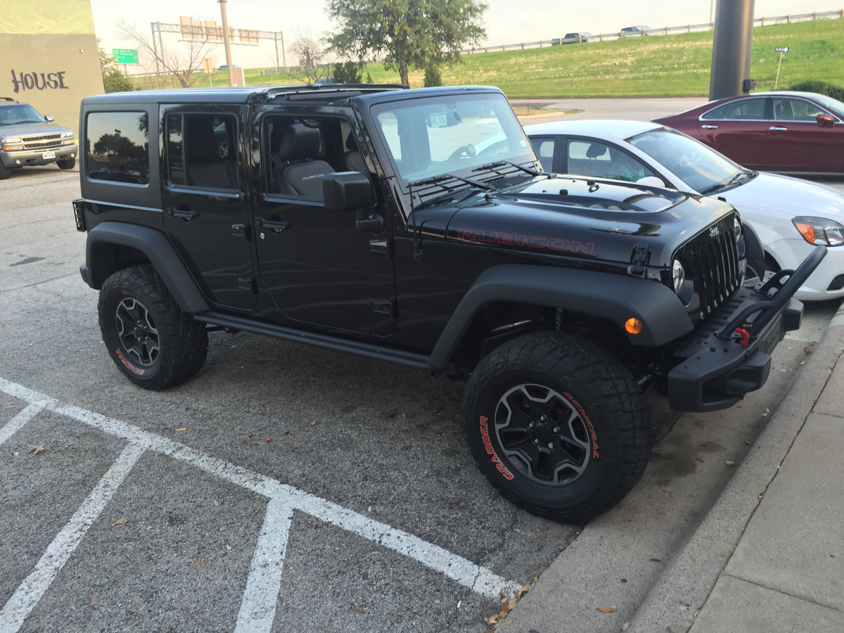

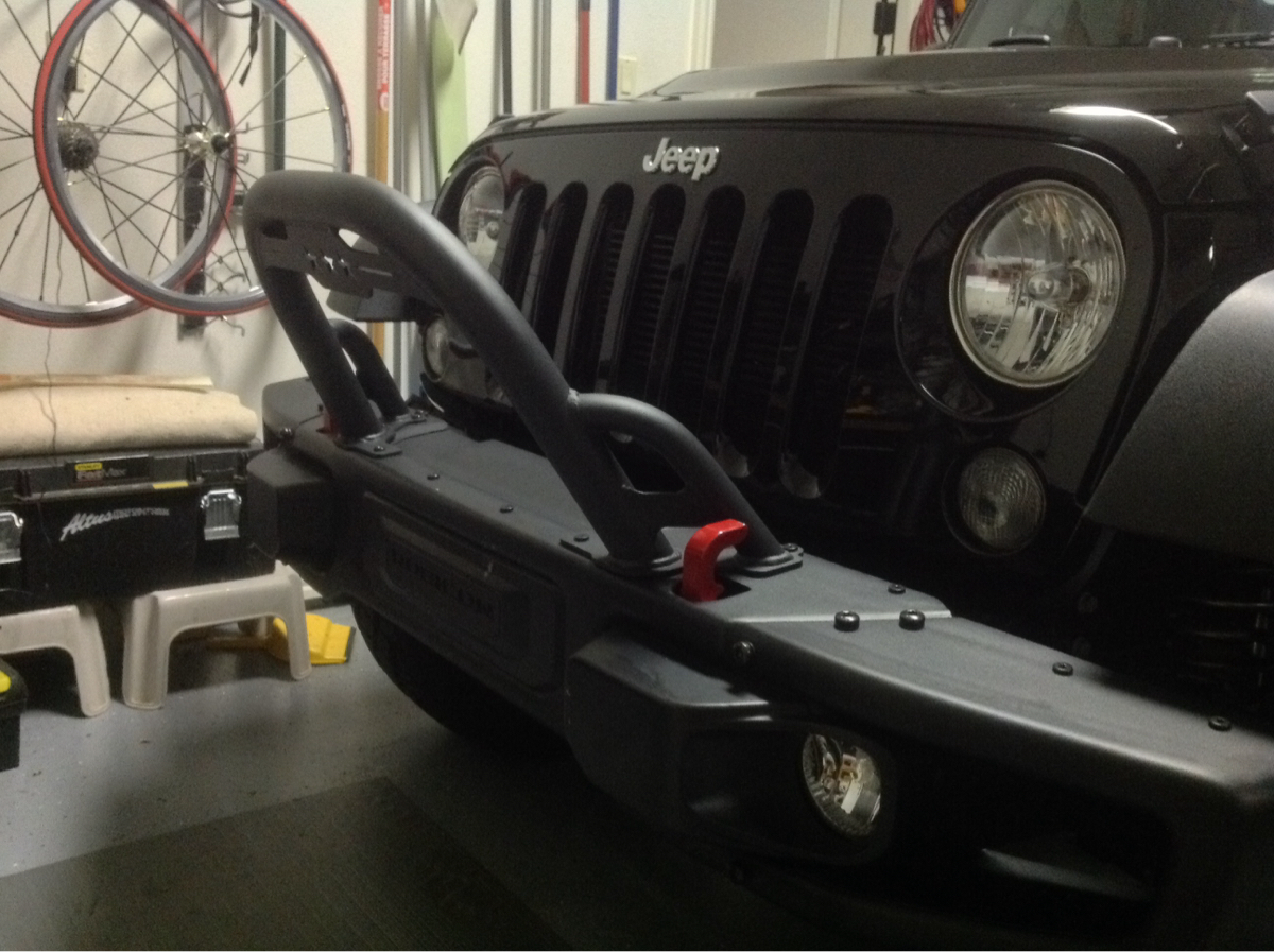

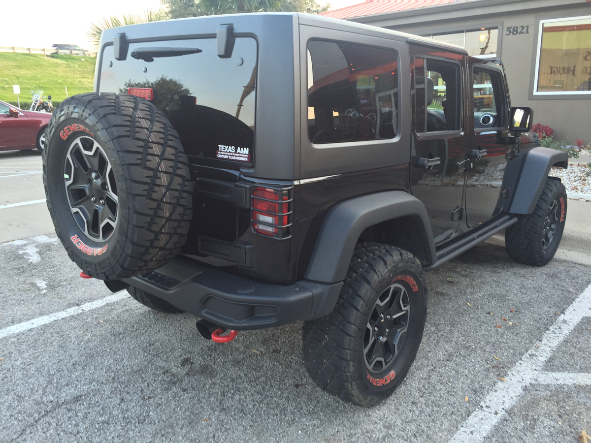

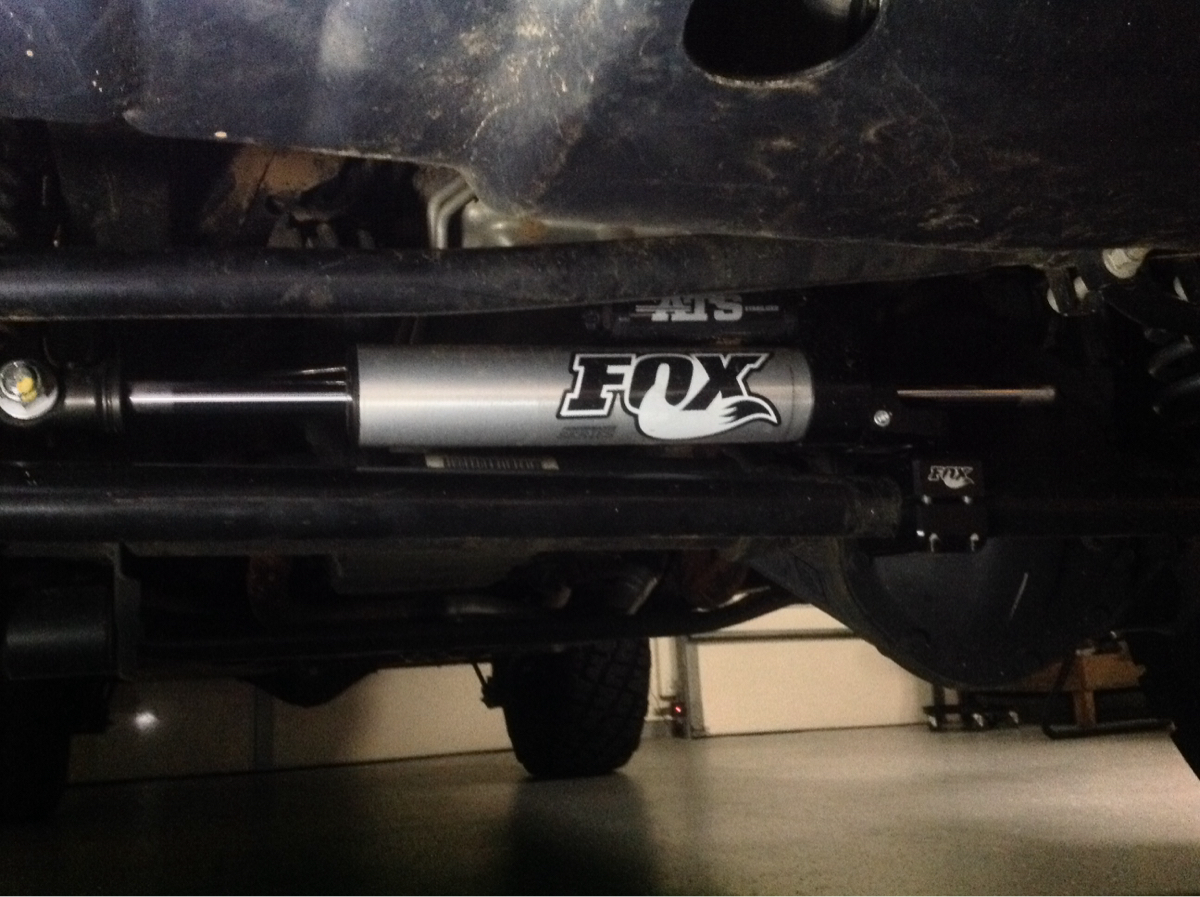

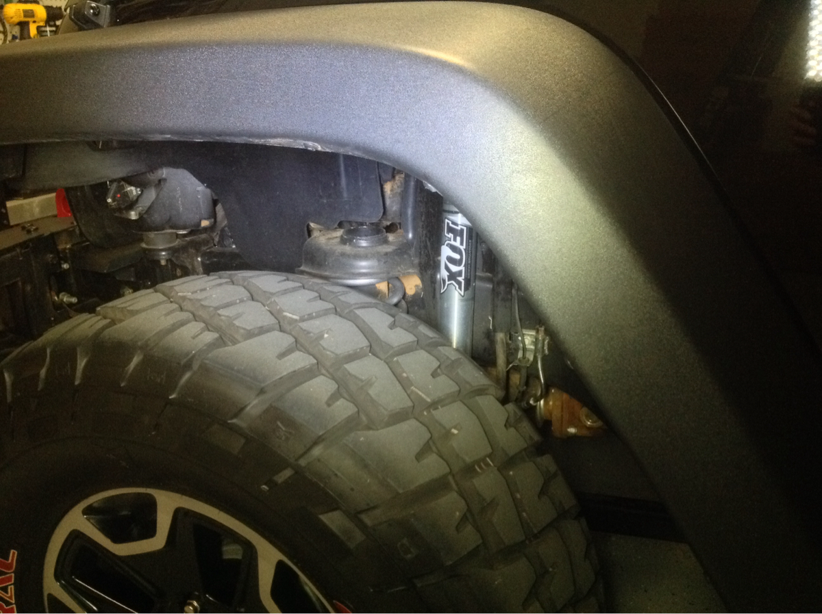

2016 Rubicon Unlimited Hard Rock, Black
- JEEP WRANGLER JK 4-DR 2.5" COIL SPRING LIFT KIT W/ FOX EVO SHOCKS. ReadyLift PART #: 49-6751
- Fox 2.0 ATS Steering Stabilizer
- General Grabber Red Letter 33x12.5 r17 Tires Mounted on the Stock Hard Rock Black Wheels
- Maximus-III Stinger Grill Guard
- K&N Series 63 CAI
- Magnaflow Black Twin Pipe Axle-back Exhaust
- Exhaust Resonator Delete
- Diablosport PCM and Trinity Tuner
- Running the Diablosport 93 Octane Tune
- Air Raid Throttle Body Spacer - Anodized Red
- Daystar Hood Latch Upgrade - no more shaking hood at highway speeds! Best $25 mod I've ever seen.
- Hard Rock Hood Vent Cut-out mod
- Tail light guards
- Shorty off-road antenna
I went with a 2.5" lift because I wanted higher, more clearance, and larger tires, but I really didn't want to raise the vehicle more than that. Being a brand new jeep, I was not ready for the fender cutting and what not to fit 35's.
Very happy with this setup.
