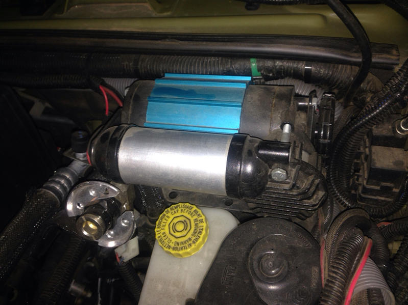

My arb fits under the hood. The viair won't?

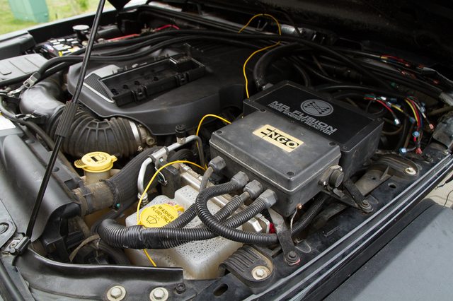

My trouble is I already have a winch box mounted and aux. relay/fuse box mounted under the hood.
So space is really not available for this size of unit.
Old Sep 30, 2014 | 01:23 PM
TRAUMAhead's Avatar
Posts: 976
From: Cen Cal
I'm digging that Mr Fusion sticker.

Old Sep 30, 2014 | 01:39 PM
Vladimer's Avatar
Posts: 1,384
From: Calgary, AB
Thanks! lol, it powers the Home Energy Reactor
Got it made through pixeldecals.com
