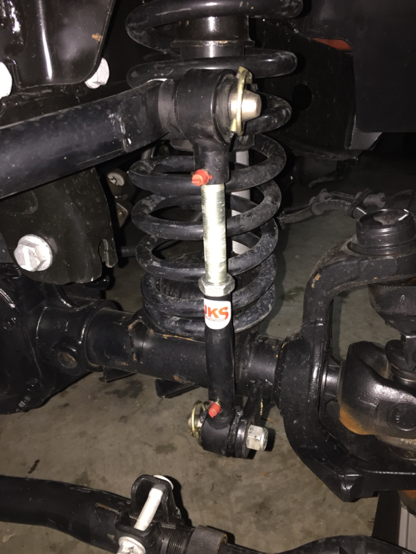

The picture that op posted is of the JKS quicker discos, but doesn't show the mounting pins. I run them on my 15 JKUR and they are excellent. Takes all of 20 seconds to disconnect. I leave them disconnected during easy wheeling and disco them for the aggressive stuff.
They are a nondisconnecting version of the disconnects. They are a different product than the quick discos.
You sure? They look pretty much identical to the JKS quicker discos I have installed on my jeep. The pic just doesn't show the mounting pins.

however it seems that it might as well be quick diso though and then just dont pull the pin , then you have tat option over no pin design . ive also wondered about these
however at the time some one said its just throwing money away (same as stock )
but it looks stronger and you can grease them plus pull the pin if need be
but i too have the button i push . lol and agree less i have to get out and do the better i like it ! but i figured if the e disco motor went these would still work no?

They really are a great product. Only hiccup is that you need to ream the mounting holes in the factory swaybar as the mounting pins are much beefier than factory. They don't tell you this in the instructions but it's not a big deal. Just can't go back to stock once you pull the trigger.
