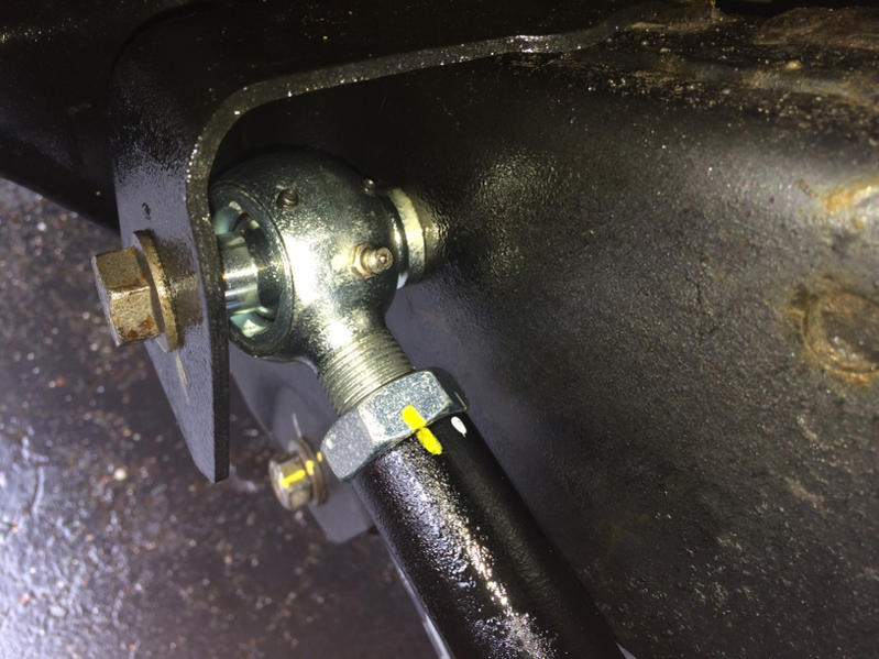

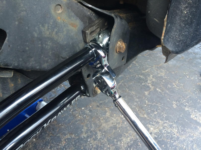

I made up a simple jig to tighten the nuts. 3.5" 2 door I set the front lowers to 24 1/4, set pinion to 2° using a jack and adjusted out both uppers out so the bolts slide through. The uppers don't have to be the same lengths. I ended up about 19 1/4 Rear, well my arms are shorter but I did the same. Set lowers to 20 1/4, pinion to -2° and adjusted uppers out to fit. Ended up around 18 1/2. Leave all bolts loose, recheck pinion/caster angles with jeep on the ground. Only when happy start torquing. The rear uppers were the only arms I was able to tighten on the jeep. I wedged metal blocks in between the joint and mounts to hold orientation.
Good luck
