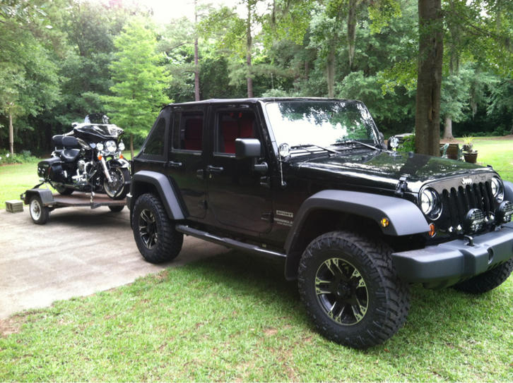

Crappy cell phone pic
Nice! Who did you order it from?

Looks great!
